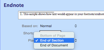

Re: Problem with section-based endnotes
You can have endnotes per section; just make sure that in the Endnote style Place popup you have End of Section checked:
en eos.png (25.15 KiB) Viewed 8733 times
bmscmoreira
Posts: 9
Joined: 2015-06-01 09:07:27
Post by bmscmoreira »
Thank you Hamid. Missed that! I am still beginning to grasp the power of Nisus, as the end editor for RTF's compiled in Scrivener.
