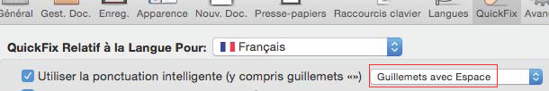

Stef wrote:[...]When typing in French (for example) does Nisus automatically insert — or does Nisus have the capability to insert automatically — non-breaking spaces before or after those punctuation marks which require non-breaking spaces in French, e.g., French-style quotation marks (« »), colons (:), semi-colons (;), question marks (?), etc.?[...]Stef
Welcome to the forum.
If you set the language of the text to be entered in the document to French, Nisus will insert the required spaces for French punctuation. You can check this in QuickFix Preferences for French:

Thanks, Hamid, for taking the time to reply, and for confirming that Nisus does indeed support the automatic insertion of non-breaking spaces with punctuation when typing in French.
It seemed to me that Nisus would support this, given the qualities of the program, but it just wasn't clear if it actually did do so.
