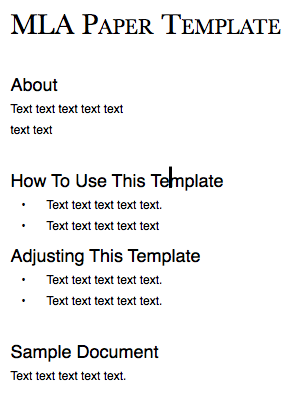

Let's say I have a document with headings like this one (see screenshot 1).
In order to select all headings with the same attributes I know I can place the cursor in a heading and select "Select All" from the small pop-up menu in the lower right corner.
[1] Is it possible to assign a keyboard shortcut to this "Select All" command?

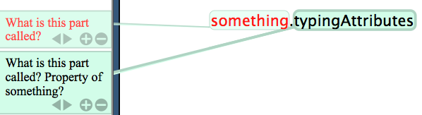

And while I'm at it, what is the part in front of the dot called?
And what is the part after the dot called? Is is called "property"?
