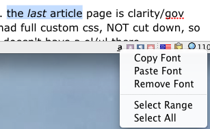

An override is a local change to a style. In the tag bar at the bottom. What I called the "Footer Style Tag" is your "Footnote Reference" character style in the bottom tag bar, I didn't have your name in front of me to use when I wrote this. But why is your footer style not a paragraph style? don't you want the font change applying to all lines in the footer?
I've made an override to the word "last" - it's in italics unlike the rest of the paragraph. the underlined a shows the override...
Screen shot 2013-09-27 at 22.21.18.png (29.41 KiB) Viewed 20071 times
Here the italics on the word 'last' is the override. Your overrides are point sizes.
First select all the lines in your footer format - click on Select All in the Character style tag when your cursor is in a Footer style paragraph. This selects all footer format lines and no others. Then in the underlined a override tag, go remove font.
