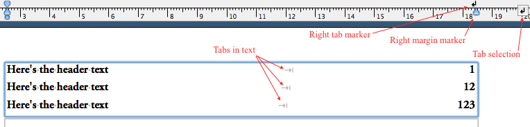

The real solution, as exegete77 suggested, is to put a right-tab point just inside the right margin, and a single tab following your text. Then however many digits your page number has they will always right-align just inside the margin. If you look at the right hand end of the ruler bar, you will see a little box with a right-angled shaped arrow pointing to the right ... that is a left tab (any text after the tab character you type will start at that point). If you click on it, you get a drop-down menu giving you different tab points; choose right tab (a leftward pointing angled arrow ... any text you type after the tab character in your text will appear to the left of that point, aligning the right end on it). When you've clicked on right-tab there, the little box will show the right-tab symbol, meaning any tab points you insert will be right-tabs, until you change type again.
Now click once at a point on the ruler just inside the right margin and a right-tab character will appear there ... that's your right-tab. Click and hold down on the right margin marker, and it will tell you precisely its position on the ruler. Double-click on the right-tab marker and a little dialog will pop up telling you its position on the ruler and you can change it to be just inside the margin by typing the number in the box. So, for instance, in the screen shot below, the right margin is at 18.45 cm, so I have put the right-tab at 18.44 (unless my memory fails me!). You need to scroll the image a little as it's too wide for the forum page.
Screen Shot 2012-10-17 at 11.30.32.png (25.06 KiB) Viewed 7118 times
Hope that helps
Re: A Problem with Page Number Position
Mark and exegete77 have this exactly right: a single tab character (in your header text) combined with a single right-aligned tab stop/marker (on the ruler) will do the trick. Thanks to Mark for the very detailed and instructive screenshots!
