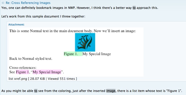

JLSchweitzer wrote:(Tip of the hat to Martin (unknowingly) for the hint to use different colors for easy illustration)
I'm curious to know how I unwittingly provided such a tip!

As far as the use of colors, it was in a post about adding Captions to images.
Martin unknowingly.jpg (58.87 KiB) Viewed 5788 times
Aha!
