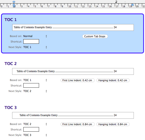

Thanks, Martin. That gets me going in the right direction. I've attached a screenshot of what I see when I select all three currently used TOC styles. However, it seems to me the default settings for the "leader tab" should be the right margin. Is there a way to do that? As it is now, apparently NWP ships (is downloaded) with a given default margin for a new document, and the TOC styles have leader tabs that match that. But, unless I misunderstand something here, if I change the margins, I need to manually change the TOC styles. Is NWP unintuitive here, or is it I who gets that label?

- ScrnCapture 2011-11-30 at 12.19.24 AM.png (52.04 KiB) Viewed 10044 times

This is actually how NWP configures your TOC paragraph styles. The trouble is that those distances are fixed at the right margin when the TOC is first inserted, and do not update automatically if you later adjust your margins. Here's how the process works:NisusUser wrote:However, it seems to me the default settings for the "leader tab" should be the right margin.
1. You create a new document. If you go to the stylesheet, you'll notice that there are no TOC paragraph styles (eg: "TOC 1", "TOC 2", etc).
2. When you first generate a TOC in the document, NWP will add the missing TOC paragraph styles automatically. When it does this, the styles have their leader tab set to the right margin location.
3. If you now adjust the right margin, the TOC paragraph styles (added in step 2) are not automatically updated.
I hope that explains the situation.
You understand correctly. Perhaps you're right that NWP should automatically adjust the TOC paragraph style leader tabs if the user adjusts the margins; maybe that would be more intuitive. There are some sticky situations, like if the user has multiple sections with different paper margins, or if the user manually changed the tab stops of each TOC paragraph style, but perhaps it's something we could consider.But, unless I misunderstand something here, if I change the margins, I need to manually change the TOC styles

After inserting TOC for the first time, set the TOC style to be based on your Normal style (instead of 'none').
Then switch to Page view and place the cursor anywhere in TOC 1 style and adjust the leader tab to the desired location.
Then from the Statusbar apply 'Redefine From Selection' This will redefine your TOC 1 style and the rest of the TOC will assume the new style defined at cursor location.
Any subsequent rebuilding of TOC will follow the new defined TOC style.
Redefining any style is much easier in Page view where you can see the result of your changes to a style before redefining that style.
