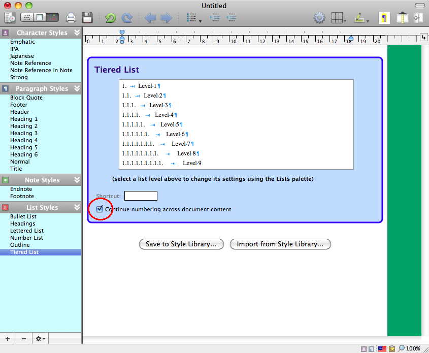

Have you checked the List Style Preference? Go to the style sheet, select the List Style you are using for the numbering and make sure that "Continue numbering across document content" is checked.

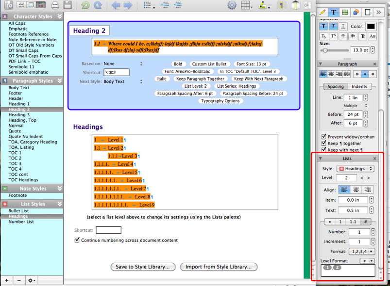

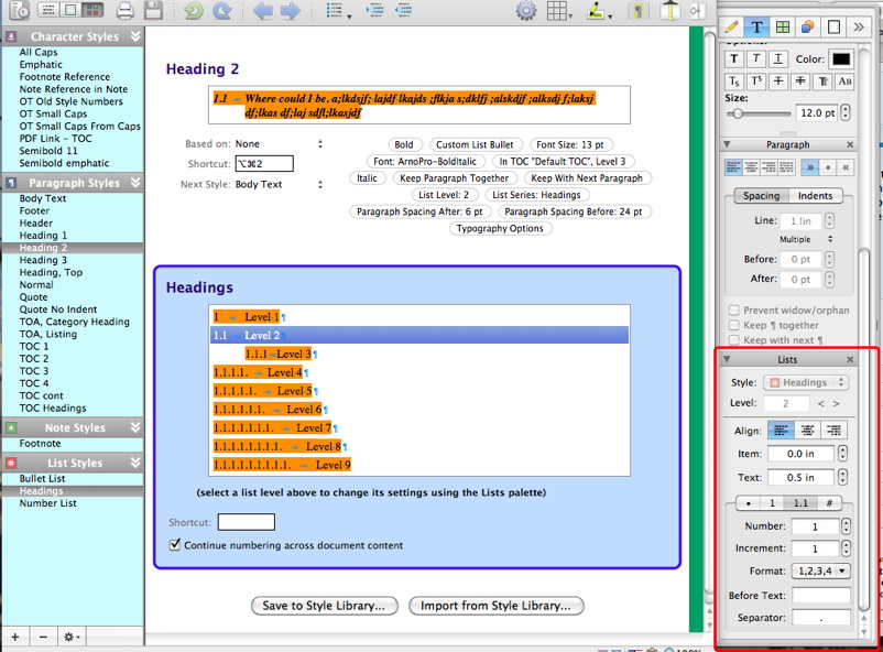

OK, the problem seems to be something very technical, but here it is. Even though your Heading styles have the "Headings" List style attached, you seem to have fiddled with the List Style definition independently. This seems to mean that the List Style of the Heading Style is not really the right List Style (I said it was technical :) ). I am attaching some graphics below to help with understanding this.
Here is the List style definition attached to the heading 2 style:
Blakers 1.jpg (75.79 KiB) Viewed 8498 times
Here is the List style defintion:
Blakers 2.jpg (74.62 KiB) Viewed 8498 times
As you can see they are not the same. :o
The solution for you is to remove the List styles from your heading styles, save the file, close/reopen and then reapply the List styles to the heading styles. If you want to change the List style definitions, do this on the List style directly (i.e., make sure you have the List style selected [blue frame in the style sheet view], and the approriate level selected)
If you think the Nisus List Styles are way too finnicky, then I totally agree with you. Clearly Nisus has to look into making this system less delicate and prone to error.

Thank you. That sorted it all out. You're right, I was editing the list style independently from the heading style. I didn't realize this would create two "versions" of the same list style.
Re: Tiered numbered headings problems
Thank you for the detailed analysis Philip. I'll just add one clarification: the numbering does not restart merely because of the custom level format applied to the heading style. In this document the numbering restarts because the "Heading 2" style actually has a restart numbering attribute applied. Unfortunately this attribute is summarized/hidden by the catch-all "Custom List Bullet" attribute bubble. I agree that this situation is confusing and we need to split these out so the attribute is not hidden and its affect is made clear to the user. Sorry for the confusion.
