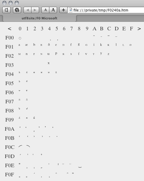

HI Kino -
it's getting stranger all the way. I installed fresh TITUS font - but same problem still. OpenOffice is fine - Word 2004, Nisus Writer Pro 1.4.1 and even latest Safari are blocked on my machine/s. Four glyphs only for me of F000 thru F0FF: just F000, F004, F005 & F0E8. Anyone to test for me?
http://elbrecht.com/utf8site/TITUS/F0240.htm
http://titus.fkidg1.uni-frankfurt.de/un ... tableUF000
note: my url got font tag TITUS; but titus url doesn't - you have to select TITUS as standard font in Safari.
Thanks HE
MacBook Pro i9
Sequoia 15.7.4
NWP 3.4.1
Kino
Posts: 400
Joined: 2008-05-17 04:02:32
Re: REDNESS
Post by Kino »
For your NWP problem, I’d like to recommend you to try some trouble shootings, e.g. clear font cache. As to Safari, it is a bad idea to use a combining character solely, without a base character. Try the attached version.
F0240a_htm.zip
(1.88 KiB) Downloaded 525 times

Hi Kino -
strangeness gone - I guess. Font Cache was not the problem, cleaning didn't change anything. But your second thought is the answer. My Corporate Use html F000 thru F08F is copied from TITUS - and I now guess the author of the RTF concerned copied therefrom again. Copy from your attached html instead and the superscripts show in Nisus Writer as well. What a hack - I never touched Corporate Use Area and didn't mind my own html source. But whatever you/me/TITUS publish in the net falls back on your shoulders some time to come. What a strange goal!
Thanks HE
PS: OpenOffice does superscripts WITHOUT base letters, but with width=zero, they end somewhere else in the back. In the end it's all a question of doing a good font for this - a linguist had to tell how to place the superscripts and I could think of a pretty well solution for a font - but it's not my job up to now: I only hope the publisher will take care...
