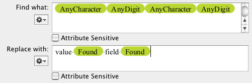

i have a problem with a huge search and replace project. maybe someone can help me. i think and hope that there is an easy way to get this done ( or maybe there is too much soccer around to study the manual).
So here is the question
i have rows of data containing informations like this
c8a1
c8a2
etc.
i want to replace them the following way
value c8a1 field c8a1
value c8a2 field c8a2
etc.
So i have to double the initial data and place some text in between. Placing the text before and after the data is not the problem, but i do not figure out how to "double" the data.
Thanks in advance
tom
c8a1
c8a2
etc.
etc.
Thanks in advance
tom
Re: search and replace question
Hi Tom- doing this might be easy or not, depending on your data. If all your data takes the form: letter, number, letter, number then it is quite simple. Just use PowerFind bubbles, which can be inserted via the gear buttons in the Find & Replace window. You'll want to use something like this:
Thank you for your help, Martin, this did what i wanted to do.

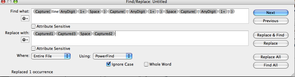

Hi Martin, now I have another search and replace question and hope you can help.
i have a large document with 8000 lines the following kind
line1 [3] [4]
line2 [2] [40]
line8000 [39] [245]
each row sores values in brackets wich are between 0 and 400
to handle them i have to place the first value after the last so that it reads
line1 [4] [3]
line2 [40] [2]
line8000 [245] [39]
Could you help me with that? I would be very grateful.
line1 [3] [4]
line2 [2] [40]
line8000 [39] [245]
line1 [4] [3]
line2 [40] [2]
line8000 [245] [39]
I think this should do it:
(capture is found in the "find what">"match" in the find window and captured is found in the replace window).
- Picture 6.png (54.36 KiB) Viewed 23672 times
Thanks Ruchama, your PowerFind expressions should indeed do the text massaging Tom requires.
Thanks Ruchama (and to you, Martin, too), I really really appreciate your help. It's the first time I get aware of the power of
