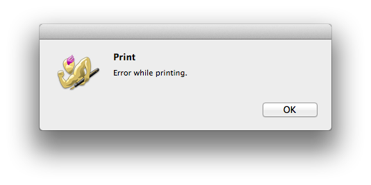

Opens the first file in the batch, then responds with
1. A Nisus dialog: "Error while printing."
error while printing
Monosnap 2018-09-25 10-19-24.png (30.88 KiB) Viewed 38227 times
[hit OK]

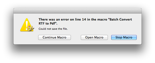

2. A Nisus dialog: "There was an error on Line 14..."
error on line 14
error on line 14
Monosnap 2018-09-25 10-20-48.png (42.38 KiB) Viewed 38227 times
[hit Open Macro]

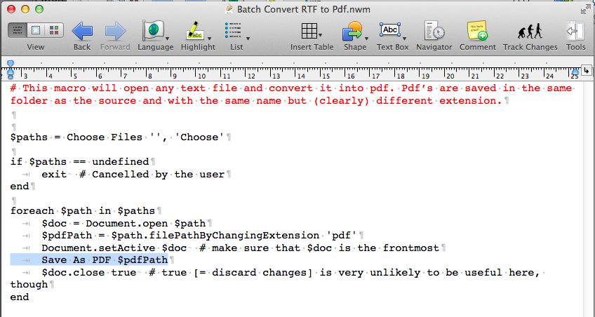

3. Opens the macro and highlights line 14:
Save As PDF $pdfPath
macro text
macro text
Batch Convert RTF to Pdf.nwm 2018-09-25 10-23-20.jpg (78.07 KiB) Viewed 38227 times

Groucho wrote: ↑2018-05-12 07:14:30 I wrote this macro years ago. It should work OK with NWP's last version too.
Batch Convert RTF to Pdf.zip
Cheers, Henry

This looks to me like "Save As PDF [path]" is broken. Without the path, the command asks to where to save the file (and automatically changes the extension). But with a path it sends the document to the printer (and ignores the path completely).
Time for a bug report.

phspaelti wrote: ↑2018-09-26 22:59:20 This looks to me like "Save As PDF [path]" is broken.
The problem here is sandboxing. Even if the user selects the file(s) to convert in an open dialog, that only gives Nisus Writer permission to those specific files. It does not grant Nisus Writer access to the enclosing folder where the PDFs are to be created. That means the PDF export will fail. It's a shame the error message is not more specific; it's a generic error raised by the macOS printing subsystem.
You can fix the problem by adding code to the macro that ensures access to the enclosing folder. For the macro given earlier adding code like this would do the trick:
$folder = $paths[0].filePathByRemovingLastComponent
File.requireAccessAtPath($folder)
I'll attach an amended macro file. The code assumes that all the selected files are in the same folder.
