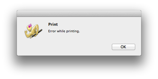

Hi, I tried this macro, but am running into problems:
Opens the first file in the batch, then responds with
1. A Nisus dialog: "Error while printing."
error while printing
Monosnap 2018-09-25 10-19-24.png (30.88 KiB) Viewed 36805 times
[hit OK]

Re: Automating PDF export with multiple files
This looks to me like "Save As PDF [path]" is broken. Without the path, the command asks to where to save the file (and automatically changes the extension). But with a path it sends the document to the printer (and ignores the path completely).
Time for a bug report.
phspaelti wrote: 2018-09-26 22:59:20 This looks to me like "Save As PDF [path]" is broken.
The problem here is sandboxing. Even if the user selects the file(s) to convert in an open dialog, that only gives Nisus Writer permission to those specific files. It does not grant Nisus Writer access to the enclosing folder where the PDFs are to be created. That means the PDF export will fail. It's a shame the error message is not more specific; it's a generic error raised by the macOS printing subsystem.
You can fix the problem by adding code to the macro that ensures access to the enclosing folder. For the macro given earlier adding code like this would do the trick:
$folder = $paths[0].filePathByRemovingLastComponent
File.requireAccessAtPath($folder)
I'll attach an amended macro file. The code assumes that all the selected files are in the same folder.
The new macro is a bit of a nuisance, since it means the user will be prompted twice, but I don't see any way around that. The only workaround would be to rewrite the macro to convert all files in a chosen folder. Selecting that single folder would give Nisus Writer read access to the RTF files and the ability to write PDF files all at once. But I'm guessing that macro is less useful than being able to pick and choose which files to convert.
