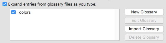

I tried to have it through the Glossary, but this does not work at all
Glossary expansions (under "Expand entries from glossary files as you type") can indeed enforce formatting. This is the correct way for an abbreviation to expand into formatted text or other rich content.
If your glossaries aren't working, are you sure they are enabled? Are the corresponding glossary files checkmarked in your QuickFix preferences? In the following screenshot you can see my "colors" glossary is enabled:
