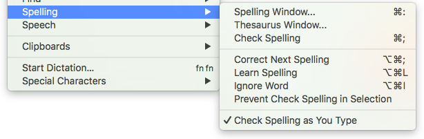

Targuman wrote: ↑2018-11-05 13:17:30So why does it say "Show Spelling and Grammar" if it doesn't actually mark or flag grammar issues? That is misleading...
Where are you seeing that? I don't see that menu anywhere. None of my menus here have the word Grammar on them:

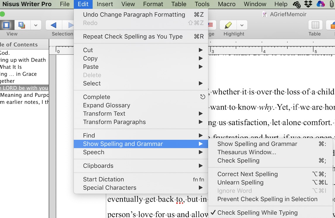

Right there in the app, under the edit menu.
Screen Shot 2018-11-05 at 6.01.24 PM.jpg (200.51 KiB) Viewed 40560 times

UPDATE: When I closed all open files, then quit NWP 3 and reopened it, the menu references to grammar disappeared.
