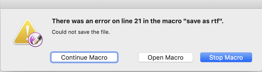

I am trying to use one of the macros provided below but I am getting an error message.
The macro is the following one:
What I am doing (with Nisus Writer Pro, version 3.0.3, macOS 10.14.6) is
1. open file.
2. run above macro.
3. get an error message: 'could not save the file'.
Attached is the macro as I saved it and a screen shot.
I would be grateful for help in solving this issue.

Re: Save to / Save as to a particular file format
The problem with that old macro is that it doesn't take sandboxing into account. The macro will need to explicitly state that it requires access to your Desktop, so it can save the file there. Here's an updated macro that fixes this:
Martin,
Thank you very much. Problem solved...
Victor
Victor
