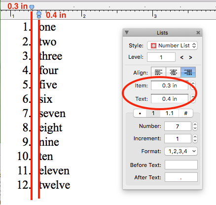

You did say "not even successfully", so it sounds like maybe you had trouble right-aligning your list items? One common cause of problems is not having enough space reserved for the list numbers. If there's not enough space to fit the list number itself, then automatic tabbing will occur, often disrupting the alignment. Make sure both the "text" and "item" indents provide enough space:
- indents.png (66.26 KiB) Viewed 9946 times

Thanks, Martin. I've never really tried custom Styles before and assumed it works like change the font for a selected block of text. I've followed your example and instructions with success. Thanks again.
