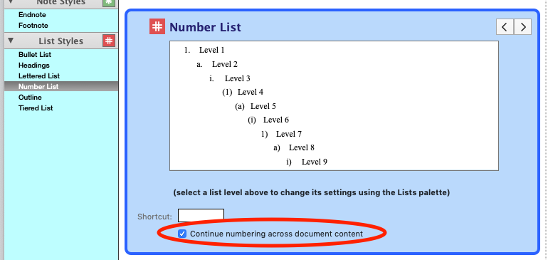

I take it you understand why this happens. Your item "21" has a restart on it which is some kind of invisible "memo" on the list item itself. Unfortunately the only way to know this is to look in the "Format:Lists" submenu, where the name of the first item changes from "Restart Numbering" to "Continue Numbering From Previous". And inside a macro the menus are not updated, so this can't even be checked. This is a bit of bummer, and frankly I think the set of list item commands in the macro language should be augmented to make this easier.
But here's another question: Why are you restarting the list at all? If you want to continue the list across intervening non-list content you should use the "Continue numbering across document content" feature in the style definition (in the style sheet).
Screen Shot 2019-02-28 at 17.16.47.png (53.57 KiB) Viewed 48011 times
