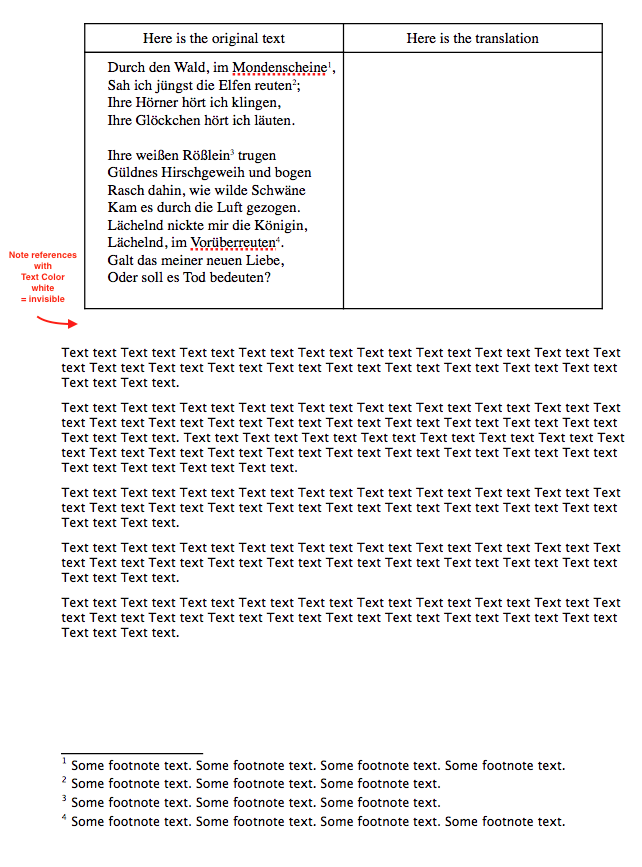

Meanwhile, you could enter numbers in superscript. Below the table, enter note references with text color white (so the true note references will be invisible.)
If you use "Note references color" you will be able to see them in the document, but they won't be printed. See Preferences > Appearance > Customizable colors > Automatic Text > Note references.
If you decide to use this method, then a macro can be written to enter the fake superscript note references in the table.

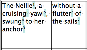

Unfortunately the numbers (i.e. the cross-references) in the table are not yet in correct order. When a third footnote is inserted, the natural progression begins to spin out of control. The numbers "2" and "3" are swapped, so that we get this:
After 7 footnotes, we end up with this:
Re: a very useful function in the tables
Posted: 2017-05-22 01:11:19
Þorvarður wrote:Unfortunately the numbers (i.e. the cross-references) in the table are not yet in correct order. When a third footnote is inserted, the natural progression begins to spin out of control.
Yes, apparently my macro was completely off. Try this new version. Hopefully this should work better. I also changed the "hiding" of the intermediary (true) reference numbers by using a paragraph style.

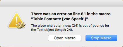

Now I can't insert anything at all because I get this error message:
The culprit is this line:
if $doc.text.characterAtIndex($fnLoc + $numFound) != 10
Posted: 2017-05-23 05:42:12
Þorvarður, I know. Sorry about that. Just make sure to add a return after the table. As it is the table can't be the last thing in the document.
This is all due to the 'hiding' thing. Since I switched to using a paragraph style for hiding the note references at the end of the table, the macro has to insert a "protective" return to make sure the paragraph style doesn't hide all the text following the table. I first forgot to test the case where there is nothing after the table before uploading the macro. And then when I noticed it and tried to fix it, I ran into other issues (which have nothing to do with the macro itself). Basically Nisus seems to have some buggy behavior with returns and styles after a table, but I just don't have the time right now to investigate this.
And I figured you would notice that pretty quickly :)
So just make sure to put a return after the table before you run it. For the time being.
