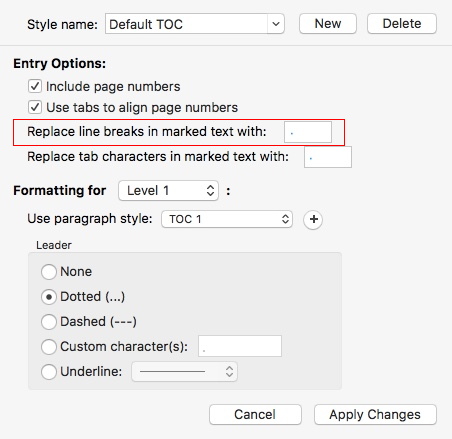

Ok, I can decrease the font size on the second line. One last thing: you mention I can substitute a ": " instead of just a " " in the TOC style but I don't find where to do that.
Re: Two line chapter name in TOC
Posted: 2017-02-24 00:19:20
As you figured out, for the differing formatting you will have to use a character style, or apply formatting by hand.
The TOC styles can be found at Tools > Table of Contents > Configure TOC Styles… Note that Nisus allows you to have more than one TOC style. If you don't set anything the style will be called Default TOC.
You can set the replacement options here:
Posted: 2017-02-24 06:11:42
by mhackney
Got it and it all works perfectly thanks!
