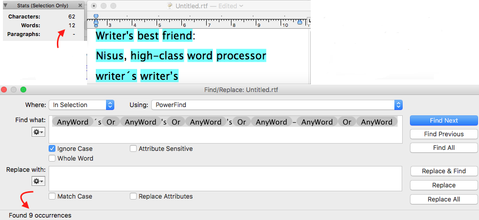

Re: Word count discrepancy between Nisus Writer Pro and Word
Posted: 2017-01-23 17:09:19
by Þorvarður
Martin wrote:
We have had requests that we add an option which allows users to choose whether hyphenated words are counted as one or two words.
If I’m not completely mistaken, this option is already included in Nisus, namely in the Find/Replace box. :-)
Samwa wrote:
Any idea why these are so different, and which is more likely to be right ?
You can use the Find/Replace box to custom tailor the word count, i.e. tell Nisus exactly how a word should look like and where word boundaries should be. Try the macro below and see if there is still much difference.
A few things worth having in mind when counting words:

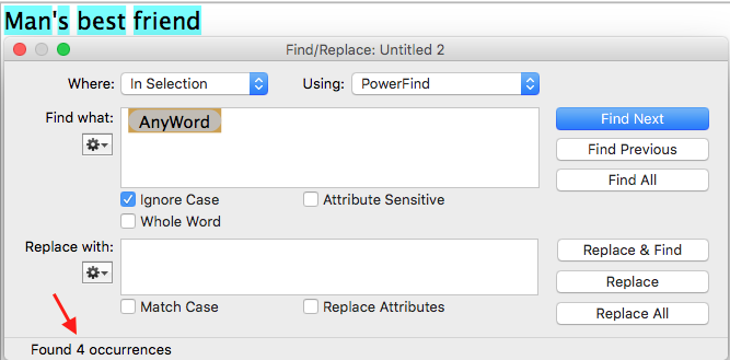

The Statistics palette and the Find/Replace box count differently. The Statistics palette counts an hyphenated word as 2 words, but delivers otherwise correct results. — Now, in case one wants an hyphenated word to be counted as 1 word, one must create a search criterion in the Find/Replace box that looks explicitly for hyphenated words; but this is not enough, because for some reason the Find/Replace box interprets an apostrophe as the end of a word. The phrase "Man's best friend" is therefore counted as 4 words if we use the Find/Replace box without any extra criteria.
The following search criteria should resolve the problem.
The third apostrophe in the search box captures (additionally) smart punctuation, in case the user has turned on "smart punctuation" in Preferences > QuickFix. The first apostrophe is what we may sometimes get when we copy text from the web.
