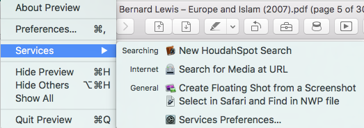

Re: Run a specific macro whenever a specific file is opened?
Hello Adrian,
Thank you for the enhanced macro.
There is a slight problem with your Service, at least on Sierra 10.12.1. It won't appear unter the Services menu in Preview and Skim. It appears in PDFpenPro and PDF Expert as expected and in Safari, iCab, TextEdit, Pages and MS Word (I didn't test more.) This limitation seems to be Preview and Skim related somehow. Both do not display any text related Services at all, i.e. Services that appear unter "Text" in the Services menu.
adryan wrote:It's important to note, too, that the solution provided by Þorvarður will not necessarily work as intended if the target Nisus document is already open but not the frontmost Nisus document at the time the Service is called.
I could not verify that. This small piece of code in the Service itself should always make it the frontmost document, no matter whether it's open or not.
tell application "Finder"
		activate
		open document file "Serial_numbers.rtf" of folder "Desktop" of folder "XXX" of folder "Users" of startup disk
	end tell
Hello Adrian,
If it doesn’t work in a Preview document, I guess the first thing I would do would be to check whether the Preview document itself recognizes a selection as text, by trying the Use Selection for Find command and/or by checking whether other text-based Services (such as Summarize) appear in the Services menu.
The "Use Selection for Find"-command works fine. As I said earlier, NO text based Services appear in the Services menu when text is selected in Preview. This is how it looks like:
If I use PDFpenPro and PDF Expert instead of Preview, then a bunch of text based Services appear, which indicates that there is something wrong with Preview in Sierra.
I googled and, lo and behold, quickly found the confirmation, but, unlike by some users below, opening the Inspector panel in Preview doesn't make any difference by me. Still no text services.
https://discussions.apple.com/thread/77 ... 0&tstart=0
I plan to update my system to version 10.12.2 later today after making a fresh clone. I will report if the problem has been fixed.

The issue seems to be that Preview does not recognize Services. Well, why use a Service then? All the Service here is doing is running an Applescript.
So just build an Applescript. Instead of using Automator, open Script Editor (found in Applications/Utilities), put in the code:
tell application "Nisus Writer Pro"
	activate
	Do Menu Macro with macro "Find Clipboard Text in Test"
end tell
and save it somewhere (script format is fine). We'll be moving it. Name it something nice. Before leaving Script Editor, turn on the Script menu in Preferences. Its in the "general" tab, labeled "Show Script Menu in menu bar". Upon clicking it, you'll see a new wavy menu on the right side of the menu bar, along with all the other icons there.
Now, we need to move our new script to the right place. I recommend your ~/Library/Scripts folder. Just put it inside there, and viola, our new applescript command shows up.
Now, unfortunately, since we are not using a Service we actually have to copy the text to the clipboard first before we run this command. So, select text, command c, run the macro, and it will work. (I hope!)
