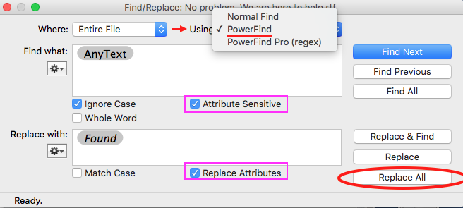

Here is what I do:
1. Underline some text
2. Open up the Find/Replace box using PowerFind
3. Enter “Any Text” bubble in the Find field
4. Select the bubble and assign it the attribute Underline Single
5. Enter “Found” bubble in the Replace field
6. Select “Found” bubble and assign it the attribute Italic
7. While still selected, assign it the attribute Underline Single
8. Repeat step 7
This works perfectly. The text is now in italic, but not underlined. No PowerFind Pro needed. :-)
