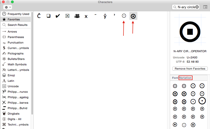

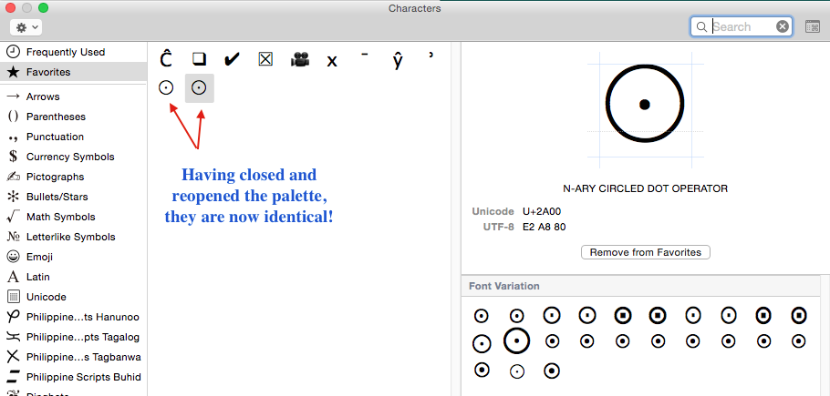

adryan wrote:the problem here is why font variations are not preserved over time in the Favorites set in the OS X Character Viewer. Is this a problem that only salv0 is experiencing?
I can confirm that when I enter font variations of "N-ary Circled Dot Operator" into the Favorites inside the Character Viewer, they retain their distinctive form until the Character Viewer palette is closed. Next time the Favorites are opened, the font variations have disappeared. Perhaps a bug in OS X?

On my computer, the font association in Character Viewer Favorites survives
Are you referring to the Font *Variation*? The screenshots show what happens by me.
