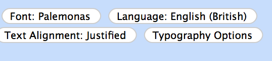

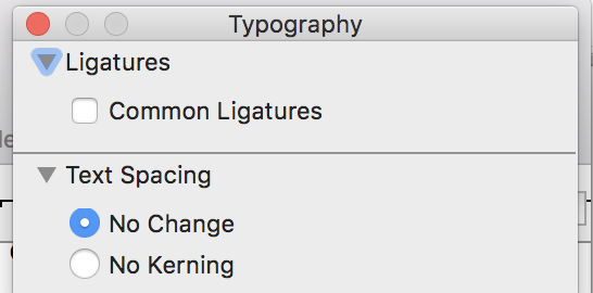

You should uncheck ligatures from the Typography panel for your Normal style from the Format:Font:Show Typography Panel menu. Note that some text in Normal style with only Palemonas font applied must be selected for the font's typography options to be revealed.) Then redefine your Normal style from the selection. This will add the "Typography Options" to your Normal style in the Style Sheet.

Hamid wrote:You should uncheck ligatures from the Typography panel for your Normal style from the Format:Font:Show Typography Panel menu. Note that some text in Normal style with only Palemonas font applied must be selected for the font's typography options to be revealed.) Then redefine your Normal style from the selection. This will add the "Typography Options" to your Normal style in the Style Sheet.
Thank you, Hamid. This does seem to work. :)
