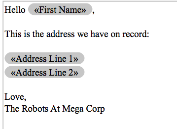

Using a normal merge workflow you might have a template document like this:
placeholder normal.png (27.29 KiB) Viewed 15475 times
If the "Address Line 2" field is empty for a particular address, you'll wind up with an empty line in the merger result. This is the problem you've described.

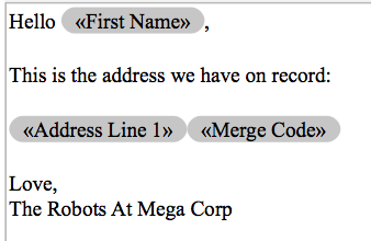

To solve this problem we'll structure the template document like this instead:
placeholder perl.png (25.28 KiB) Viewed 15475 times

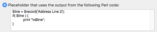

That "Merge Code" placeholder can be inserted via the menu Insert > Merge Placeholder > Other. You'll choose the option for some Perl code:
perl code.png (16.2 KiB) Viewed 15475 times
Here's the text version of the code in the screenshot:
$line = $record{'Address Line 2'};
if( $line ) {
	print "\n$line";
It's nothing fancy. It just checks to see if the address line is empty, and if so, doesn't print anything. If the line isn't empty, then it prints a newline (return) and the line.

The only inconvenience is formal in nature, in that the template has to be structured a little differently than the desired output. For example, rather than having
«Address Line 1»
«Address Line 2»
you have to have
«Address Line 1» «Merge Code (for Address Line 2)»
In other words, the merge placeholders have to be on the same line rather than on two different lines.

I tried the above code and continue to get the following error:
The following error occurred while attempting to run the merge placeholder's Perl code: Unrecognized character \x{a0}; marked by <--HERE after <--HERE near column1 at (file location).
I am using merge data from a csv file created from numbers. The output looks ok, bu I get the error on every record.
Any suggestions?
Re: Merged Documents & Empty Lines
Posted: 2016-01-12 17:18:07
macjohnnv wrote:I tried the above code and continue to get the following error:
When you copy the Perl code in Safari it adds non-breaking spaces (U+00A0), which Perl does not tolerate. If you first paste the code into a regular Nisus Writer document and show invisibles, you can replace the non-breaking spaces with regular spaces. I hope that helps, let me know know if you have any more trouble.
