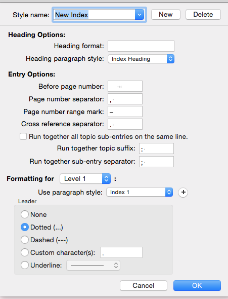

Invoke the index pane from the Tools:Index:Configure Index Styles... menu.
Overwrite the selected "New Index" with the name of your choice.
Press the OK button.
The newly named index will appear in the Tooldrawer under Reference Tools:
It will also appear in the Tools menu just under Configure Index Styles..
Whenever you want to add an index entry to say a subject index, make sure that the Subject Index is active (checked) as shown.
