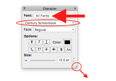

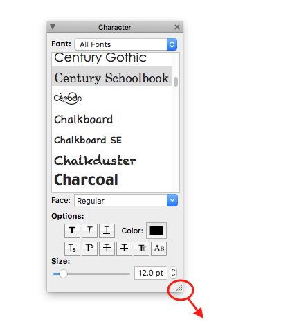

Century schoolbook unavailable in Nisus
Then the font is not installed on your machine. If you have installed it, then make sure you see the Character palette in Nisus (Window –> Palettes –> Character). If you click in the lower right corner and drag, then the shape of the palette changes so you can scroll up and down and choose the font you need.
