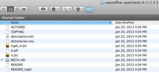

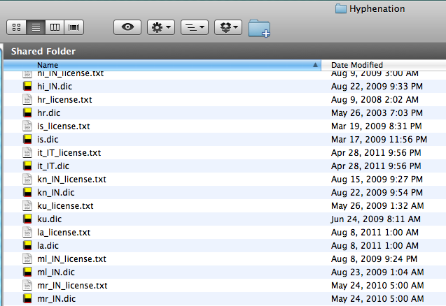

The files that come from the .oxt file downloaded from http://extensions.libreoffice.org/exten ... leases/1.3 don't seem to be named the same as the ones I see in the mentioned folder for NWP (see other screenshot). (I had to change the .oxt file to .zip so I could access the files.)
Should I change the name of the .dic file hyph_lt.dic file to lt_LT.dic and put it in that hyphenation folder? Then will hyphenation work for Lithuanian?
