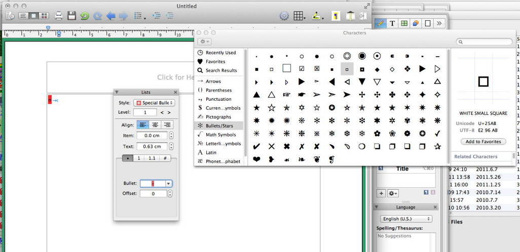

Here's how I type directly into the bullet pull-down menu in the list settings. (Note: this will only "take" once you move the cursor to a different field of the list settings.)
Nisus Custom Bullet.jpg (68.85 KiB) Viewed 11535 times

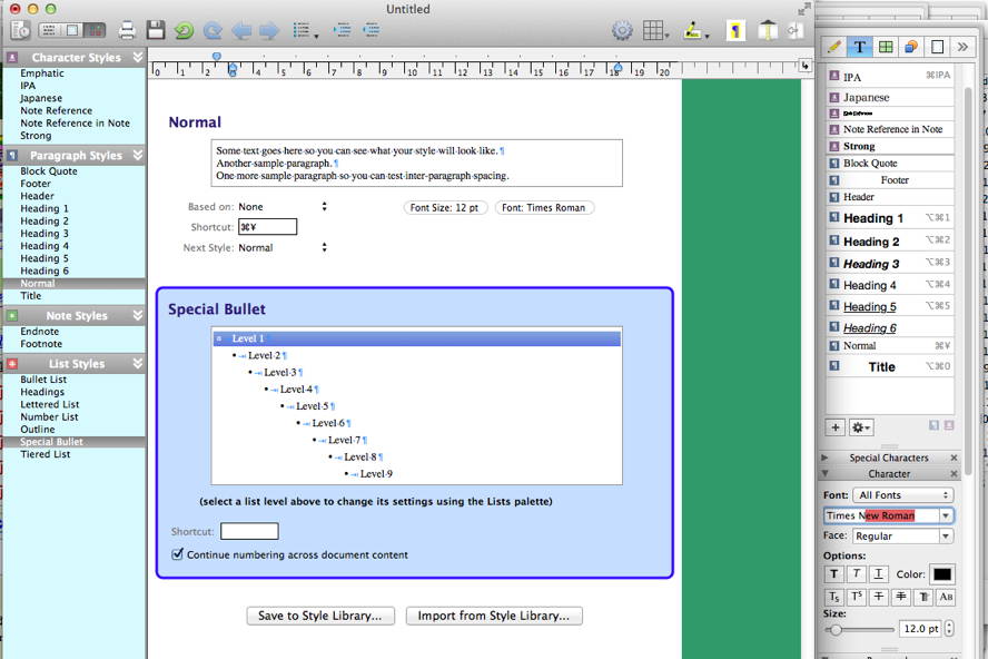

Here is how I format the bullet in the style menu.
Nisus Format Custom Bullet.jpg (88.99 KiB) Viewed 11535 times

Again, many thanks, Philip.
I'll give that a try today.
Re: Changing the Size of Bullets in a List
Posted: 2013-05-03 12:08:00
by wwgreaves
Philip,
I followed your first example, and it worked. As you said, it only "takes" once you move the cursor to a different field of the list settings. I was able to make the change, save the document, and have the changed bullet appear when I opened the saved document.
I'll try the style menu when I am more familiar with how it works.
