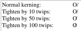

Elbrecht's suggestion to use a Unicode combining mark is a good one. You could also just tighten the kerning:

I'll try the tightening, but in some cases there were several words in a row, with an overstrike on each character and space. I suspect it won't look right, but I'll try it.martin wrote:Elbrecht's suggestion to use a Unicode combining mark is a good one. You could also just tighten the kerning:

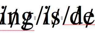

Hi, new problem with this. Unanticipated base-line shift with different characters.stevenrowat wrote: I can quickly add them to a whole string of existing text just by alternating the pattette and the arrow key to move the cursor. Nice.
What happens is that the overstruck '/' is moved vertically to be centered with the character.
So, a 'g' which has a long descender, the '/' is shifted downwards with the g, and so on.
My goal is to replicate old typewriter overstriking, and unfortunately this doesn't look like it at all.
The '/' characters should all strike at exactly the same height in the line, with the same baseline.
See uploaded screen-shot. When you have a whole line of these, it's very obvious that it's ragged and doesn't look like it was done by a typewriter. It also makes it harder to read what's being overstruck (which can be read easily in a true typewriter-type of overstrike, which I want).
Any way to get the overstrike character to stay to the baseline?
Really this seems like a bug somewhere. Combining characters should keep both the originals at their standard baseline heights, no?
Steven Rowat
Re: Overstrike possible in Nisus?
I'm glad you are happy with this typing solution. But just in case you get tired, I have written a little macro that will apply such dashes to a stretch of selected text in one go.stevenrowat wrote: I can quickly add them to a whole string of existing text just by alternating the pattette and the arrow key to move the cursor. Nice.
Design your own font?stevenrowat wrote: Any way to get the overstrike character to stay to the baseline?
You seem to misunderstand what an overstrike solidus is for. Somebody went to a lot of trouble to carefully match the baselines of the solidus with the characters to be overstruck. You are trying to misuse a feature.stevenrowat wrote: Really this seems like a bug somewhere. Combining characters should keep both the originals at their standard baseline heights, no?
They actually seem to have used the vertical center rather than the baseline (if you look at my screenshot), but your point is taken. Fair enough. I have no idea what the solidus overstrike was designed for. I wish someone had designed it to do my job, but apparently they didn't.phspaelti wrote:You seem to misunderstand what an overstrike solidus is for. Somebody went to a lot of trouble to carefully match the baselines of the solidus with the characters to be overstruck. You are trying to misuse a feature.stevenrowat wrote: Really this seems like a bug somewhere. Combining characters should keep both the originals at their standard baseline heights, no?
Designing my own font is a bit beyond me (and I don't really want to use a font that has no descenders anyway), so I guess I'll have to give up.
It would seem easier to design another solidus overstrike, that stayed at the baseline for the whole font, no? Or is that what you meant when you said "design your own font"?
And, I haven't tried the macro -- you say it overstrikes the dash? Would that be the same as the Nisus strikethrough macro? (ie.: ------------). The Nisus one already does multiple letters...is yours different?
SR
The solidus is supposed to form new characters. So the type designer has carefully matched the solidus to the character so the whole looks good. If the solidus were on the baseline, it would stick out at the top on the "g" and not cross the descender. That would look really ugly in isolation.stevenrowat wrote: They actually seem to have used the vertical center rather than the baseline (if you look at my screenshot), but your point is taken. Fair enough. I have no idea what the solidus overstrike was designed for. I wish someone had designed it to do my job, but apparently they didn't.
You may think that the computer is "overstriking" the character, but in fact the combination is stored as a whole and the layout agent knows to replace the character sequence "g"+"U+0337" with the visually combined form.
Well that suggestion was at least partly in jest. I wouldn't want to try that myself either. But if you did, you wouldn't lose descenders, you would just have to create combined characters for each character in the font. With the proper software this is done in a graphic interface, so it would mainly involve a lot of time-consuming busy work, I think.stevenrowat wrote: Designing my own font is a bit beyond me (and I don't really want to use a font that has no descenders anyway), so I guess I'll have to give up.
No, it "overstrikes" the solidus, so it would allow you to do what you were doing before--laboriously--in one quick go. If you look inside, you will see that I specified the solidus by number ("0x0337"), so you could replace that number with the number of any other combining form and it would "overstrike" with that.stevenrowat wrote: And, I haven't tried the macro -- you say it overstrikes the dash? Would that be the same as the Nisus strikethrough macro? (ie.: ------------). The Nisus one already does multiple letters...is yours different?
But here's the thing, I really wonder why you are trying to do things this way. I can understand the desire to reproduce an old document faithfully; I often do the same thing. But I usually do so, so I can do things like search the document. That is I try to reproduce the document logically. In your case it sounds like this overstriking was form of editing (crossing out?) that was used. I would want to reproduce that with a style, that graphically could be represented with a colour or a (visually separate) strike attribute, or a background color. This would also allow it to be changed easily.
The strikethrough approach completely destroys searchability. If you overstrike "Nisus" with a solidus, the text is logically "N/i/s/u/s/".
The overstrike was a hack back then, dictated by the technical limitations of the time. Is it so important to reproduce the graphical impression that faithfully? If so maybe, you should just scan it, and put it in as a graphic.
Just my two cents worth.
