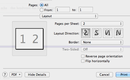

I think it should be possible to do what you want. Check 'Use Facing Pages' in the sections palette and use odd and even headers to place page numbers.
Then when you print, under Layout options select 2 pages per sheet as shown in this screenshot.
