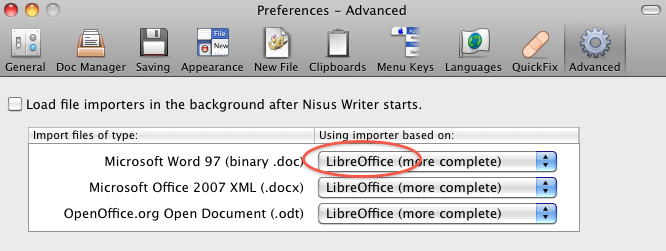

Just to be sure you're using/launching the correct version of NWP (instead of another version sitting somewhere on your computer with the old PPC importer), can you please check your NWP preferences? Go to the "Advanced" tab and look to see that the "LibreOffice" based importer is shown:

Hi Martin, yes, LibreOffice importer, exactly as per your screen. And, yes, it's the same every time and with every file regardless how often I try. Just stops when it's in the background.
