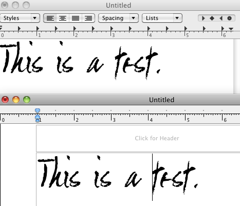

NWP does support OTF fonts as much as the OSX text engine allows, but that should be at least as much as TextEdit provides.
I downloaded the Chemist font from here, and it looks fine to me:
(TextEdit on top, NWP on bottom)
Are you seeing something different?

Thanks, I was before, but I downloaded and re-installed and mine looks like this in NWP also.
The problem I had at first was that the Chemist and Chemist Rough didn't get given separate names and both appeared under the family 'Chemist' as 'regular'; there were two Regulars showing up in the NWP list. Then on the NWP page itself NWP seemed to be trying to draw both of them at once.
This time I didn't install the base Chemist, just the 'Rough', and it is showing up as yours -- which I think is actually the 'Rough'.
I think the designer did something wrong with the naming, because there was a confusion in the two types in TextEdit also, as I recall -- although TextEdit did manage to render them differently.

Ah yes, I also had some issues with the font names. Well, I'm glad everything is working properly for you in the end!
