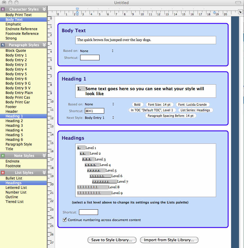

I've attached a screen shot of my Outline page in Style Sheet view.
It's pretty straightforward really. You go menu Bar > View > Style Sheet.
Then you click on the + sign at the bottom left of the window to make a new Paragraph Style. Name it what you want -- in my case here, "Heading 1". Then select the sample text and format it in the normal way in the. Then go to the Lists panel and select "Headings". You can also have the heading listed in the Table of Contents so it appears in the Navigator Panel (and in a ToC you generate). In the graphic attached, you will see the Headings list formatted in a particular way. That was to suit me. I formatted that beforehand, then made the styles using those formats.

Wow! Boy oh boy.
I knew a bunch of that about styles, but your list tip did the trick and the navigator pane (new to me) is going to change my life.
I've been a Nisus user for a decade or so, but you just doubled my productivity. Thank you.
