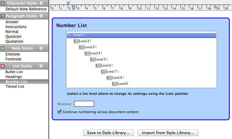

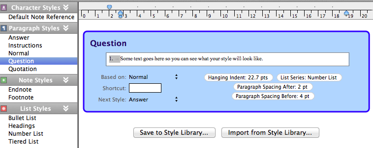

I think that the problem is that you're trying to set your hanging indent in your <Question> style. Try checking the settings in the <Number List> style and adjust them for the format — full-stop or not, tab-space, etc. — for what you want in hanging indent terms and simply let <Question> call that; remove any tab-marker you have entered. I have an M/C template set up — I keep it separate from my New File. It looks like your "before" image, but saved perfectly well. You will see I prefer ballot-box bullets rather than letters for the answer (Though I have been known to combine them!)

Question Style
Question Style
Screen Shot 1.png (64.33 KiB) Viewed 10759 times
Number List Style
Number List Style
Screen Shot 2.png (65.87 KiB) Viewed 10759 times

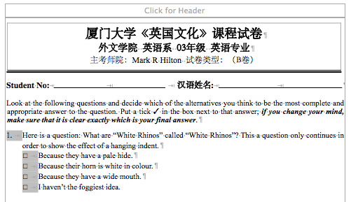

M/C Test
M/C Test
Screen Shot 3.png (53.33 KiB) Viewed 10759 times

You are correct in that I should have said FIRST line indent, instead of HANGING indent. My apologies. I will attach two files to show in better detail what I'm trying to do. Unfortunately, this word processing abilities of this forum don't allow me to clearly show what I'm talking about.
I should add that what I'm trying to do in overwrite the current number list (shown in Number List below) with the pseudo-hanging indent (also shown below). As I said before, I've edited the Numbered List and then use "Redefine Style from Selection" but this doesn't stick. Since this is a very common task, I want this Style to be included in my default template so I've also tried opening the New Nisus File, changing this Style Sheet and saving it but alas, this style sheet reverts back to the regular old Number List.
