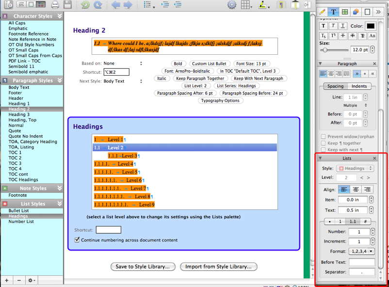

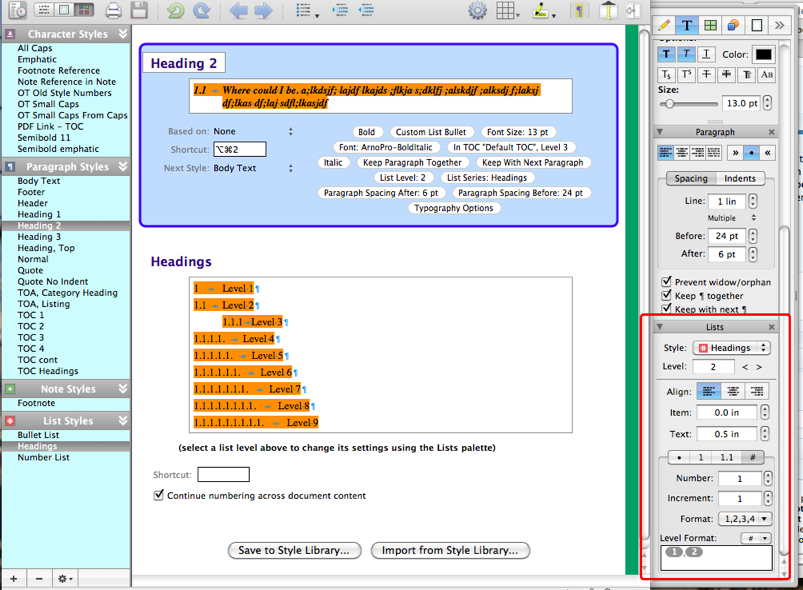

OK, the problem seems to be something very technical, but here it is. Even though your Heading styles have the "Headings" List style attached, you seem to have fiddled with the List Style definition independently. This seems to mean that the List Style of the Heading Style is not really the right List Style (I said it was technical :) ). I am attaching some graphics below to help with understanding this.
Here is the List style definition attached to the heading 2 style:
Blakers 1.jpg (75.79 KiB) Viewed 8502 times
Here is the List style defintion:
Blakers 2.jpg (74.62 KiB) Viewed 8502 times
As you can see they are not the same. :o
The solution for you is to remove the List styles from your heading styles, save the file, close/reopen and then reapply the List styles to the heading styles. If you want to change the List style definitions, do this on the List style directly (i.e., make sure you have the List style selected [blue frame in the style sheet view], and the approriate level selected)
If you think the Nisus List Styles are way too finnicky, then I totally agree with you. Clearly Nisus has to look into making this system less delicate and prone to error.
