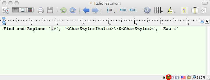

Re: Simple Macro not working
Hello again,
I have downloaded your files and I even had a look at the movie. Well you are doing everything correctly. That is how it should work.
I have identfied the culprit that is preventing your macro from finding anything, and it is a ruler. I don't know how it got there, but if you remove it from the macro, the macro should work.
best
Philip
best
Philip
- FindItalicMacro.jpg (25.44 KiB) Viewed 20115 times
