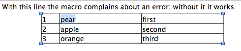

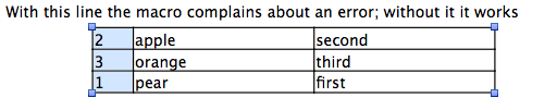

Re: selection before first cell of table
Posted: 2010-12-16 16:41:31
It works for me. If I select something in the 2nd column before the macro runs, eg:
Picture 1.png (12.11 KiB) Viewed 16755 times
And run your macro, the table has been sorted by the 2nd column, eg:
Picture 2.png (12.2 KiB) Viewed 16755 times
Is that not what you're seeing? If you simply want the insertion point to be in the first table cell after the macro runs, add the line:
Select Start
To the very end of the macro.
