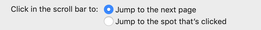

We did fix a scrolling problem where the following system preference wasn't always respected:
But that was fixed for Nisus Writer Pro version 2.1.9 (before 3.0), some time ago. That was the last notable fix for basic scrolling. It sounds like that's not related to the behavior you're seeing.
Re: decimal tab problem, chosing character with which to align.
