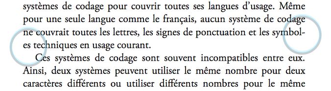

by Kino
Elbrecht wrote:Kino seems to ask for SHY without allowing hyphenation at all
Because Allow Hyphenation does something very wrong to other languages than English at times.
