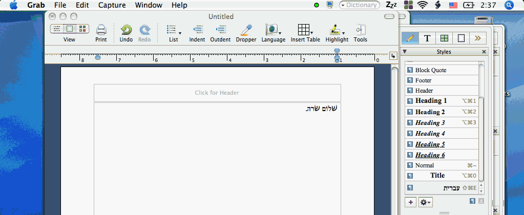

When I type the Hebrew letters Shin or Sin into a document, they are not formed properly, as in this file:
Hebrew misformed.gif (43.76 KiB) Viewed 21312 times
However, after I close the file and reopen it, the shin and sin are properly formed, as in this file:
Hebrew saved and reopened.gif (44.29 KiB) Viewed 21318 times
I have submitted this as a bug ever since NWE 2.0, but it has never been fixed. Am I the only one with the problem? Can anyone else reproduce the bug and help me convince Nisus to fix it?

What you've shown is odd. The first thing that strikes me is that the font in the first screenshot appears to be completely different from the one in the second. Have you changed the font, or does this occur automatically after the file has been reopened?
Re: Misformed Hebrew Shin and Sin
Posted: 2008-06-20 15:05:30
by DavidK
The font is not different - I didn't change anything. The only letter that appears in a different font is the shin - the other letters are all New Peninim MT in both screenshots.
Posted: 2008-06-20 15:23:53
Perhaps that is exactly the problem here. In the screenshot with "malformed" shin characters font substitution may have incorrectly occurred for some reason. How are you typing the pointed shins exactly and with what keyboard layout? Can you walk me through it in steps a non-Hebrew typist could follow?

A little more information: I am using 10.4.11 - if this problem does not occur in leopard, that would certainly be a reason to upgrade. I also occasionally have the problem of New Peninim MT initially appearing inclined, and having to go to the font palate to remove the italics.
I have a Hebrew style that has the following characteristics: Language - Hebrew; font - New Peninim MT; size 16pt; text alignment - right. I choose this style and type shift-w, which should give me a shin. I get the malformed shin (with the shin dot over the right side of the letter), with the Lucida grande font substitution. When I type an option-w, which should give me a sin (with the sin dot over the left side of the letter), I get a malformed sin (in lucida grande font). When I type a plain w, I get a regular shin/sin with no dot over the letter to distinguish between a shin and a sin.

By the way- it is not malformation- it is simply Lucida Grande letter that is much larger than the corresponding New Peninim letter. There , I think, is the riddle for Nisus people.
Posted: 2008-06-23 14:57:45
Thanks for the extra information David. I tried out your steps and was able to reproduce the problem, both in NWP and TextEdit. It appears to be some bug in Apple's text engine regarding the pointed shin in this particular font. And while the problem manifests on the latest version of Tiger, it appears to be fixed on Leopard. I don't believe there's anything we can do about it, unless Apple decides to fix the problem on Tiger as well, which seems unlikely.

I did recreate David's style to initially test the bug, but it's not required. Any time New Peninim is used the bug can reproduce. Perhaps you used a different keyboard layout? I used the "Hebrew-QWERTY" keyboard layout and typed the pointed shin via Shift (or Option) + W.
