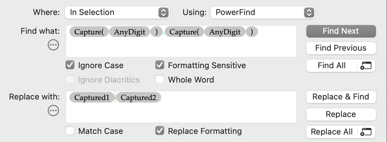

Well I did it (I hope) by using this:
... where the tiny character between "Captured 1" and "Captured2" in the Replace field is a comma, selected and formatted to be Format > Character Style > Note Reference.

No, it didn't do it. It screwed up the replacements.
Back to the backup.
Edit: It did do some. It just mangled one set of two superscripted note references, and I don't know why.
