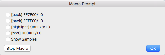

I think one difference to Kino's macro is that his macro enables one to find and select any Highlighted and any Background color as well as colored text in the document. No part of the document needs to be first selected.
The "samples":
I just thought I should point this out, as this might perhaps be useful for someone else who needs to work with Highlight and Background colors.
