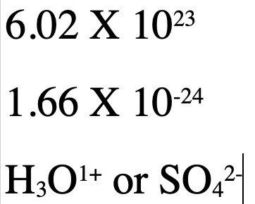

Hi, Patrick G,
I tried your macro. Thank you! Here's what I got:
Scientific Notation Sample.png (19.26 KiB) Viewed 119523 times
