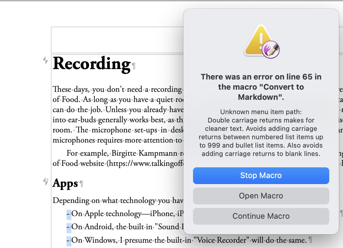

I've just tried your macro, as well as the other one by @tomoyuki-kosaka on a file with headings, bold, italics and bullet-points.
The @tomoyuki-kosaka macro worked, so I copied the result and pasted it into a plain text document which I opened in Marked2; it looked fine except that the bullet points were not properly rendered. I was able solve the problem by simply editing the .md file I created and replacing single carriage returns with double.
Your macro threw an error as follows:
Screenshot 2022-12-31 at 12.41.jpg (213.83 KiB) Viewed 33888 times
If I "continue" the macro, the text has had the double carriage returns inserted, but only the text without any of the markdown code is placed on the clipboard.
I'm happy to be told I'm doing something wrong.
P.S. I tried doubling the carriage returns myself in NWP before running the macro. Still getting the same error alert.

Mark, Thanks for letting me know. I forgot a # in front of the comment line. :P It works now. 8)
