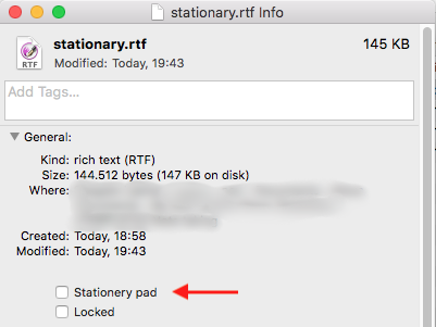

Until this has been fixed, I thought I might be able to use .rtf files as Stationary pad in the Document Manager because, when opened, a copy of the original file should be automatically created, but alas, Nisus doesn’t seem to recognize Stationary pads in the Document Manager. Moreover, if a Stationary pad file is opened in the Document Manager, altered and saved, the Stationary pad attribution is removed from the file in the Finder!
