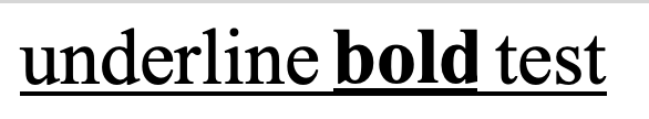

I misunderstood/misread your earlier message and thought you were seeing something like this:
The system hasn't done that quirky/buggy underline drawing in a long time.
Now that I understand what you're describing, I see the same behavior on Big Sur. Bolding a single word that's part of an underlined phrase will thicken the underline for the entire phrase, if the bold font face has thicker underlines. This behavior makes decent sense to me, though I suppose it's debatable what's best. I don't know any way to influence this, aside from choosing a different font.
