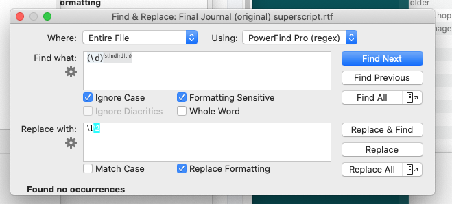

I am having no luck trying to follow your suggestions--probably something I am doing wrong.When I follow your instructions, I get the "Found no occurrences" message from NW. So I am guessing that I am doing something wrong in the Find box. Here is a screen shot. Can you see anything I have done wrong?

I suspect you have just copied and pasted the Find expression from my Forum posting. But the Forum superimposes additional formatting which will be sought by the Formatting Sensitive stipulation but is unlikely to be present in your document.
If you type in the expression afresh yourself and go through the procedure I outlined, it should work. Alternatively, you can select the pasted expression in the Find field, then invoke Format > Remove Formatting and Styles, and then apply the Superscript to the second parenthesized expression once more.

Frank Einstein wrote: ↑2021-01-16 12:31:59 I am having no luck trying to follow your suggestions--probably something I am doing wrong.When I follow your instructions, I get the "Found no occurrences" message from NW. So I am guessing that I am doing something wrong in the Find box. Here is a screen shot. Can you see anything I have done wrong?
Adrian's explanation are fine, but the first step I recommend when you are getting "Found no occurrences" on a styled search, is to turn the "Formatting Sensitive" off. Make sure to try "Find next" or "Find All" rather than "Replace All" at that point. And since in fact there is a good chance in most documents that this will be finding exactly what you want—since most documents do not mix numbers and letters in this way otherwise—you'll have what you want.
The truth is "Formatting Sensitive" search can often be avoided. And I recommend avoiding it whenever possible.
