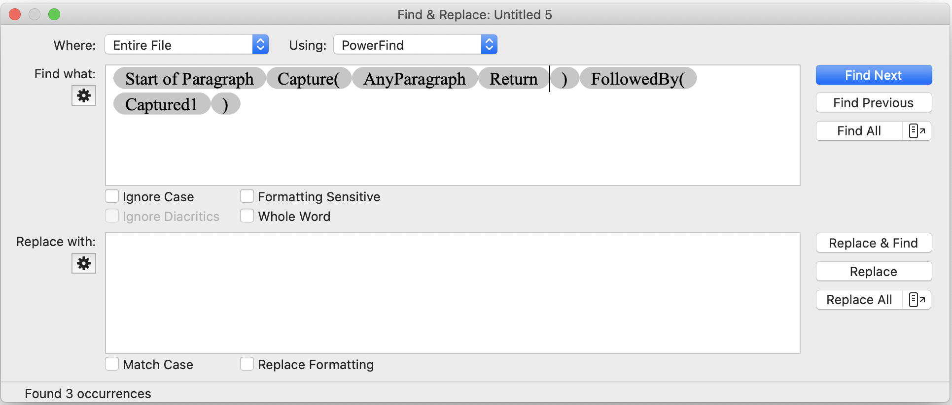

Generally all of your solutions would be possible approaches, though some are easier to approach than others.
Since you have the headlines already with a style you can just keep those and delete the ones before them. So find paragraphs that are followed by an identical paragraph. In Powerfind this will look like this:
Find Preceding Duplicate Paragraphs.jpg (118.81 KiB) Viewed 29192 times

Also one other approach you can use in similar cases:
  1. Select the styled paragraphs
  2. Replace the selected text with—or just insert—a special marker of some kind
  3. Find the paragraph followed by the special marker
This method can be useful when the styled paragraph does not have some otherwise recognizable pattern. It’s also easier than trying to do the same via styled search.

Philip has provided excellent solutions for you.
Another would be to delete the first paragraph following each Section Break — if blog posts were separated by Section Breaks.
Yet another would be to make use of any date stamping that might be associated with a post.
But allow me to address the broader issue raised by your query about whether you are thinking about it in the right way.
The general approach would be to formulate a Find string that finds either or both of the paragraphs in question. It's then a simple exercise to delete the one you don't want.
You've been trying to do this, so you're on the right track, but some of your candidates could lead to misadventure.
For example: "Find every sentence that doesn't end with a period (series of words followed by a carriage return)". The assumption here is that all such sentences occur only in blog headings. It's very easy to omit a concluding period at the end of an ordinary (non-heading) paragraph. One might even have been there originally but then been deleted inadvertently during some subsequent cut-and-paste maneuver or the like. Even in your own posting here, not every paragraph ends with a punctuation mark. So this particular approach is risky.
Another example: "Find any string of words that is followed by a carriage return and then the identical string of words…". In your present situation, I would only do this when the string consisted of an entire paragraph, because it's not inconceivable that you would find (and delete) the wrong thing.
The aim is to find something that is consistent throughout your document and specific enough to find all the sought occurrences and no unsought ones. This can indeed be a real challenge at times.
The key is to know your document. And not just what it should contain, but what it actually does contain. Only then can you tailor grep expressions that will do what you want. (I include PowerFind expressions here.)
With a 50-page document, it would be prudent to attack it with the power of grep only after making a duplicate, in case of mishap. I might add that it is playing with fire to rely on Undo (Cmd-Z) to bail you out of trouble. Any number of things could go astray and prevent you from backtracking. 50 pages can be a lot to unscramble or rewrite.

the original method worked great. The breakthrough for me was discovering that a paragraph according to Nisus doesn't need punctuation.
I hadn't expected that.
