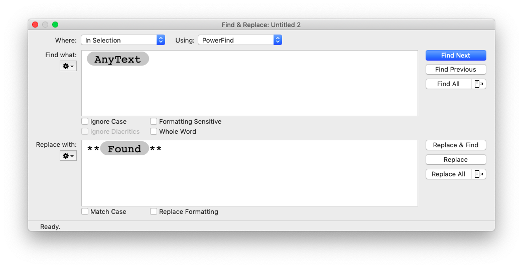

I just checked the online manual for NWE, and it seems it should allow you to macroize Find expressions. Since the task you are looking for can easily be achieved using "Find and Replace", aka "PowerFind", you might be able to get the same that way.
The Find Expression you want looks like this:
Screen Shot 2020-08-16 at 24.16.41 .png (114 KiB) Viewed 14030 times
If you macroize this expression (after switching to PowerFind Pro - easier to post here), you will get a one line macro like this:
 Find and Replace ".+", "**\0**", 'Es-i'
This is to my mind at least, considerably more comprehensible than that archaic Macro Block stuff. YMMV.
